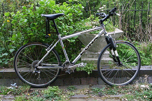

I've got Continental Sport Contact slicks on my hard tail Kona as I only use it as a town bike. They pump up to 90 PSI and ride fine, though you need to be careful of ice / wet grid covers / wet road markings as they can on occasion loose traction. I'd buy another set though, they are good tyres. Massively less cycling effort than low pressure knobly tyres.
Tony.

The ride is a bit hard, but much of that is down to my front forks being pretty crap so I feel it in the wrists a bit. Nothing using gloves doesn't fix. I plan to stick rigid forks on it at some point as I reckon I waste a lot of effort making those tired old forks bounce.
Tony.
