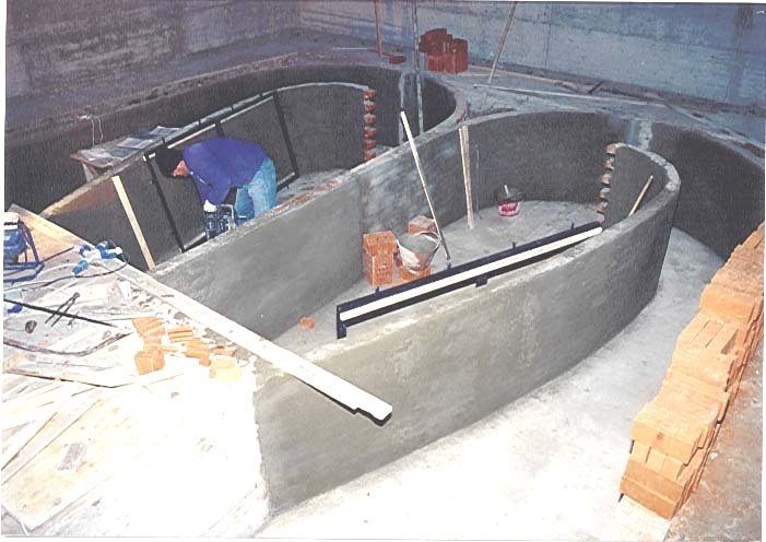

worlds largest subwoofer
http://www.royaldevice.com/custom3.htm

From what I remember its a horn loaded bass driver, so it only needs a few watts! crazy eh?
blimey,a house that will resonate to 1 hz using 1 watt,now that is clever:)
that guy must like bass then
