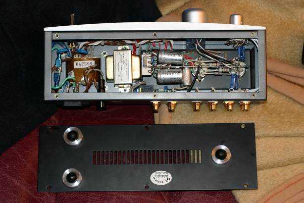

WM, can you outline what's different (it's kinda like looking at one of those "there are 10 differences between these pictures - see if you can spot them all" things)?
John
PS. No plans to modify my MM until the warranty runs out in 2008 :D
Ok guys here's a stock one.............
Yep thats a Kev mod, plus those 2 larger 5.6uf units marked 'Living Voice'. made by 'Iew'
So Far replced the 0.1ufs bypass with some serious quality units, changed the resistors on the input side for 102 Visheys, rewired a couple of runs, new sockets to go in FRiday, along with the rest of the cap changes, new main rail wiring, a couple of Quantum filters.
And the new Valves will be here, I procuded that Genelex Goldeb lion for the Rectification stage :-), plus the Correct 4003 mullard's cryo'd.
I would like to point out these are pretty basic mods, nothing thats not been done before, but its a low cost project so it would keep it all in perspective (except the golden lion valve :o )
Should help bring it all together a little more. Wm
The maker is ICW, you used to get them at Maplin, when Maplin still sold quality components.
Interesting to note that you removed the Teflon V-Cap's and replaced them by Hovelands. I tend to avoid Hovelands myself....
For the Minimax the sound is dominated by that dreadful Alps "High End" Pot and and the basic circuit + Valves.
I would suggest completely replacing or completely dropping the cathode bypass capacitors on the input valves, Rubycon SWR or a range of other low voltage mylar capacitors are a great choice and drop that Alps thing, replacement even by the cheapest 470k linear track carbon pot plus a 10k lawfaking resistor is needed, better choices, such as the PEC carbon pots exist. Then a really high quality output coupling capacitor should be used (I know what my first choice would be).
I personally would also replace the input valve anode resistor and the cathode follower valve cathode resistor with constant current sources, but some may feel that this makes the preamp too little "tube" sounding.
Finally, if the mains transformer can supply enough heater current, changing the valves to 5687 will make another major step forward.

NO T, the other way round, I think Hovalnd are dire sir :)
To be fair, yes I could do the from scratch thing T.
However, Its a play thing for a while, Valves I'm still learning plus I hate vol knobs :D .
THough I do cheat, set the MM to the correct setting and use the Vol control on the Wadia, cheat fair I always say :D
Hooking up the power amp direct this morning, has shown in no small terms how far off the MM is from main sound, oddly enough in vocal dept.funny old world isn't. T.
